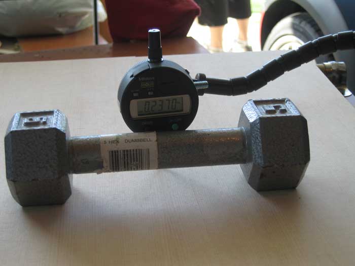

PostPosted: Thu Nov 01, 2007 9:38 am
John there are ton of ways to do deflection testing.
I do it with 2 wooden rods placed a fixed distance apart and use a 5# weight that I stole from my wife... Luckily she doesn't read my posts!!!!   I don't know the distance off hand, I would have to go measure it. I use a dial indicator attached to an adjustable arm.
I zero the indicator, add the weight and see the change.
Thin the wood, measure again. I also keep track of weight so that I can keep track of density etc. I give me another means of comparison of different woods.
When you use deflection, the wood had to be the same width if you are going to compare longitudinal deflections.
I only had 1 pict on my computer so I will post it.
